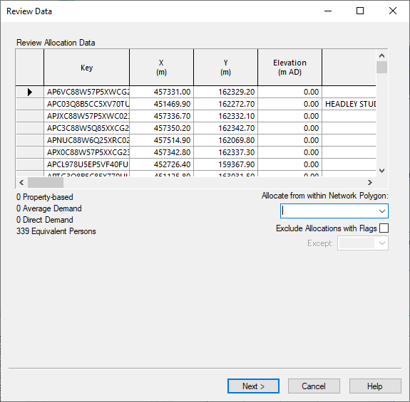

The review page of the Static Demand Allocation wizard allows you to view the points that will be used for allocation in future steps, and make changes to the data if required. There are two versions of the review page:
  • The standard review page is displayed prior to carrying out the allocation process. It lists all the points to be used for allocation. You can make changes to the points, and limit which points are used for allocation
  • The special review page will be displayed if there is missing data that is required before allocation can continue. One or more special review pages may be displayed.
Standard review page
InfoWorks reads through the points that can be used for allocation in future steps, and displays them in an editable grid.
This grid can be used, for instance, to fill in data for fields that were not included in the imported data.
A count of the objects in each category type is displayed below the grid.
Limiting allocation
This page can also be used to limit the customer points used for allocation, by setting a bounding polygon. Only customer points within the bounding polygon will be considered for allocation.
In the case of parent and child customer points, the parent customer point must be within the bounding polygon for the parent and child group to be considered for allocation. If the parent customer point is outside of the bounding polygon, any children inside the polygon will be excluded from the allocation process.
It is also possible to limit the customer points that are included by setting a flag. Any customer points that have already been allocated, and have their Allocated Pipe ID field flagged with a flag other than that selected in the Exclude allocations with flags list, will be excluded from the allocation. The flags can be viewed on the customer points grid.
Each time the options limiting the points used are changed, a progress bar titled Scanning Customer Points may appear as InfoWorks rebuilds its list of included data points.
Next
Click Next to continue. If you have chosen to re-allocate existing points, you may see a progress bar entitled Clearing Previous Allocations.
The pre-allocate page of the Static Demand Allocation wizard is displayed.
