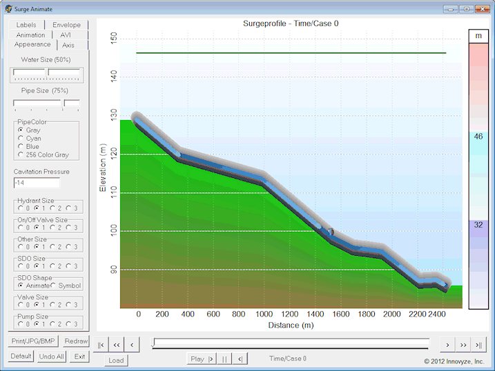

The Surge Animator (which utilises the KYPipe Surge engine) is used to display live animations of pipe profiles, tank and reservoir levels, pump speeds, water flow, and velocity rates from transient simulation results.
To run the Surge Animator from InfoWorks WS Pro, select the Run Surge Animator option from the Results menu.
Surge Animator options
Appearance
| Option | Description |
| Water Size | For increasing or decreasing the number of moving segments used to indicate direction of flow. |
| Pipe Size | For adjusting the width of the pipe. The width of the pipe also affects the appearance of pumps, tanks, reservoirs, and surge devices. |
| Pipe Color | For changing the colour of the pipe. If the 256 Color Gray is selected, the entire animation will change to 256 Color Gray scale. |
| Cavitation Pressure |
Cavitation is depicted in the animation as a black space with coloured dots in the interior of the pipeline. The value entered for cavitation pressure will determine when and where cavitation is indicated in the profile. |
| Element Size |
Many of the elements included in the pipe profile may be sized using these individual scales. Setting size to '0' makes the element invisible. Note: The size of the pipe (see Pipe Size above) will also affect the size of certain elements. |
