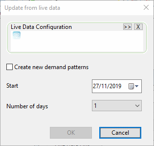

Update From Live Data dialog
Use this dialog to specify which live data configuration to use to update a demand diagram, and associated requirements.
This dialog is displayed by right-clicking a demand diagram object in the Model Group window and selecting Update | From live data, or by selecting the Update category from live data button on the Demand Diagram editor.
Option
Description
Live data configuration
For specifying the live data configuration to use for the update.
You can drop one into the box from the model group window, or you can click the >> button to open a selection tree.
You can update factored demand from live data. The live data point needs to have the data type "NUMBER" for this to work.
This box will already contain a live data configuration if one is open in the workspace.
Create new demand patterns
If checked, new demand patterns are created as required.
Start For specifying the start date of the period during which data will be extracted. All updated patterns will take data from the same date range.
Number of days The length of the period during which data will be extracted. From 1 to 7 days.
OK Generates a text report listing the outcome. Shows errors, the list of patterns created or modified, and the number of values added.
