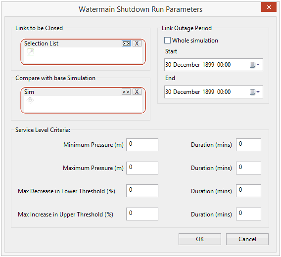

Watermain Shutdown Run Parameters dialog
The Watermain Shutdown Run Parameters dialog, allows the outage duration of a selection of links to be specified for a Shutdown simulation. Service Level Criteria for the production of Service Level Reports on completion of the simulation are also set in the dialog.
The dialog is displayed from the Schedule Hydraulic Run View when:
  • Shutdown is first selected in the Run Type dropdown list
  • When the Options button is clicked with run type Shutdown already selected.
Show image
Section Description
Links to be closed
Selection List Drop Target
Use drag and drop or use the Browse button to add a selection list of links to be closed during the simulation.
Link Outage Period
Whole Simulation
Check this box to apply link outage throughout the simulation.
Uncheck the box to specify an outage Start and End time.
Start and End
Enter a start and end Date and Time for link outage. At least one of the Start and End times must be within the run Start and End times.
Compare with base Simulation
Use drag and drop or use the Browse button to add a simulation to which the current simulation results will be compared when producing a Service Level Report.
Show Service Level Report at end
Check this box to display the Service Level Summary dialog when the simulation is completed.
Set the Level of Service Criteria to be used in the production of Service Level Reports from simulation results.
  • Minimum Pressure and Duration
  • Maximum Pressure and Duration
  • Max Decrease in Lower Threshold and Duration
  • Max Increase in Upper Threshold and Duration
