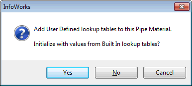

Creating user defined tables for a built-in material
  1. Double-click the User checkbox for the material.
    A dialog is displayed. Show image
  2. Do one of the following:
    • To create user tables, initialised with the same values as the built in tables, choose Yes. The User option is selected.
    • To create empty user tables, choose No. The User option is selected.
    • To abort the process altogether, choose Cancel. The Built In option remains selected.
