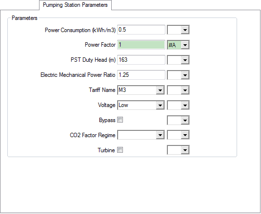

Electricity tariffs can be assigned only to pumping stations.
Tariffs can be assigned in two places:
- The Pumping Station Parameters page of the Pump Station property sheet
- The Pumping Station grid view in the Links grid
Show image
For pumping costs to be calculated, information is required in the following fields:
| Data field | Description |
Power Factor |
Ratio between electric power used and electric power supplied. Should be <=1. Default is 1. |
Electric Mechanical Power Ratio |
Ratio of total electric to mechanical power for the pumping station. A measure of efficiency. Should be > 1.1. Default is 1.25. |
Tariff Name |
Name of the Electricity Tariff component. Can be typed in or selected from the dropdown menu. |
Voltage |
Either high (>1000v) or low voltage electric system. |
Electricity Tariffs are edited using the Electricity Tariff editor.
