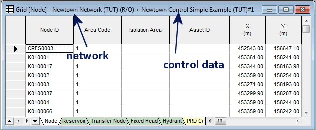

The title bar of network views changes when there is control data associated with the network. The network name is on the left, followed by the control data name. The read-only state is displayed for each. In the above illustration, network AVALON is read-only and control data AVALON#2 is read-write.
