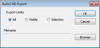

Export to AutoCAD DWG. This will display the
AutoCAD Export dialog.
- In the AutoCAD Export dialog, select export options as required:
- Export Limits:
- All - export all objects in InfoWorks WS Pro network layers in the GeoPlan window that have display turned on (in the Display column of the Layers And Themes page of the GeoPlan Properties And Themes dialog).
- Visible - export all objects displayed in the GeoPlan window within the constraints of the current zoom.
- Selection - export currently selected objects only.
- Export Limits:
- Use the Browse button to choose a name and location for the exported file.
- To export the file, click OK.
