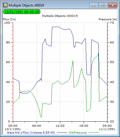

Results can be graphed for a selection of network objects, allowing results from selected objects to be compared.

  3. Select an attribute from the Left list and from the Right list. These are the parameters to plot on the two axes.

    • Use the Swap Left/Right button to switch the two lists. The list on the left is displayed on the left axis of your graph.

  • On graphs produced by the Pick Graph tool (Graph) tool or the Graph Selected Objects tool (Graph selected objects) tool (see Graphing selected objects), the red time line shows the current time of the simulation, mirroring the current time of the simulation on the GeoPlan. To jump to a different simulation time, you can drag the red line to the desired simulation time directly on the graph. The simulation date & time will be updated accordingly on the GeoPlan.
  • To display a label showing the value of the trace at the current time of the simulation, right-click the graph view and select Auto-label traces.
