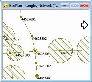

You can switch on an option that allows you to automatically pan the GeoPlan window. To switch this option on or off:
  1. Choose Options from the Tools menu. This displays the Options dialog.
  2. Switch to the GeoPlan page.
  3. Check or uncheck the Enable auto-panning check box.
With the option enabled:
  • Large arrows appear when you move the cursor close to the edges and corners of the GeoPlan.
  • Click with the left mouse button to scroll the view in the direction indicated.
  • Click and hold down the left mouse button to scroll repeatedly in the direction indicated.
GeoPlan with automatic panning cursor visible on the right

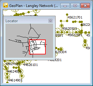

GeoPlan locator
You can use the GeoPlan locator map to move anywhere within your network. The GeoPlan locator displays a simple schematic of the entire network, with a highlighted box displaying the current location of the GeoPlan window in relation to the network as a whole.
If you move the cursor over this highlighted box, it changes to a Locator map pan cursor.
With this cursor showing, click and hold the left mouse button down. You can now drag the highlighted box anywhere within the network. Release the mouse button to pan the main GeoPlan window to this location.
GeoPlan window displaying locator map
