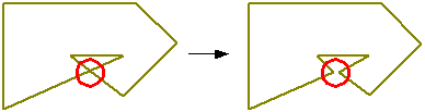

Correction is used to edit the geometry of self intersecting polygons in such a way that the shape no longer intersects itself.
For example:
Examples of correction of self intersecting polygons
