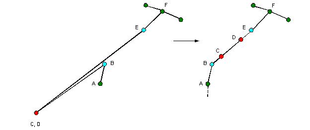

Coordinates from linear inference
Coordinates are inferred from upstream and downstream node positions and from pipe lengths. The orientation of the link(s) is inferred from the coordinates of connected nodes and the spacing of nodes without coordinates is interpolated from pipe lengths.
For inference to take place, the upstream and downstream nodes must be:
  • connected to two pipes
  • have X and Y coordinates
Coordinates from Linear Inference Example

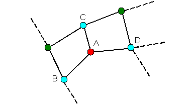

Infer coordinates from connected nodes
Coordinates are inferred by averaging the coordinates of connected nodes.
Example
Coordinates of Node A, inferred by calculating the average of coordinates of Nodes B, C and D
