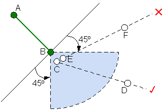

For merging to take place, in addition to satisfying the parameters specified in the Inference Editor, the following rules must be satisfied:
  1. Only one node found within Search Radius that is connected to only one pipe
  2. Pipe to be connected must be connected to two nodes
  3. Pipe to be connected must have difference in bearing greater than 45°
When running the Merge Nodes (Inline Proximity) rule for Node B:
  • If Node C is found, merging will take place as the difference in bearing between pipes A-B and pipes C-D is within the allowable limit.
  • If Node E is found, merging will not take place as the difference in bearing between pipes A-B and pipes E-F is outside the allowable limit.

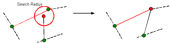

The Snap Nodes to Pipes rule is used to search for nodes connected to one link within a user defined Search Radius of another link. If user defined parameters are satisfied, the node will automatically be inserted into the link within the Search Radius, creating a junction (example 1).
Snap Nodes to Pipes example 1

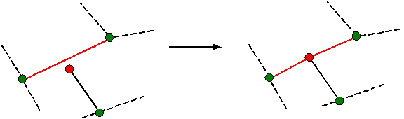

If a node is within the Search Radius of the node connected to one link, and the Elevation Tolerance is met, nodes will be merged to create a junction (example 2).
Note:
The Elevation Match Tolerance defined for the Snap Nodes to Pipes rule is only applicable in the case where a node is within the search radius.
Note:
Demand allocation to nodes may be lost during node merging. Inference functionality is intended for use at the data cleanup stage. Therefore, it is not expected that any demand allocation will have taken place before Inference is used.
Snap Nodes to Pipes example 2

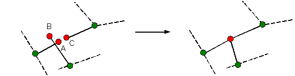

The Merge Nodes (Proximity) rule is used to search for nodes connected to one link within close proximity of one another and coalesces them into a single node.
InfoWorks searches for nodes within a user defined Search Radius of each other. If the nodes found are within user defined diameter tolerance and elevation tolerance, the nodes will be coalesced into a single node.
Merge Nodes (Proximity) Example
