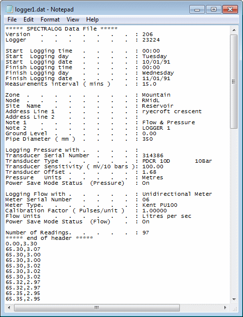

The Spectralog format logger data is a comma separated format. Spectralog files are structured in the following way:
- Header area containing information regarding:
- the version and logger type, start logging time, day & date, finish logging time, day & date, measurements interval (mins), zone, node, site name, address, notes, ground level, pipe diameter.
- the parameters being measured (pressure and flow, in the screenshot below) & specifications of the corresponding loggers (such as serial numbers, units, etc)
- Logger data listed in comma-separated columns, e.g. pressure & flow, as shown in the example below:
An example of Spectralog file (.dat extension) is shown below:
