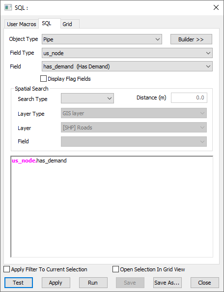

Example 1
The very simple example below shows a query to select upstream node for a pipe that has demand.

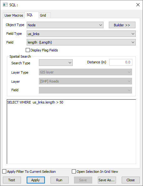

Example 2
The example below shows a query to select nodes where the upstream link length is greater than 50.
A node will be selected if the query is true for any of its upstream links.

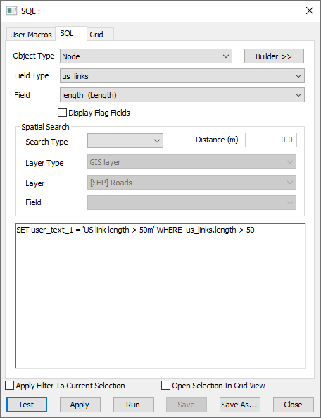

Example 3
The example below shows a query to set user text 1 where upstream links are longer than 50 m.
