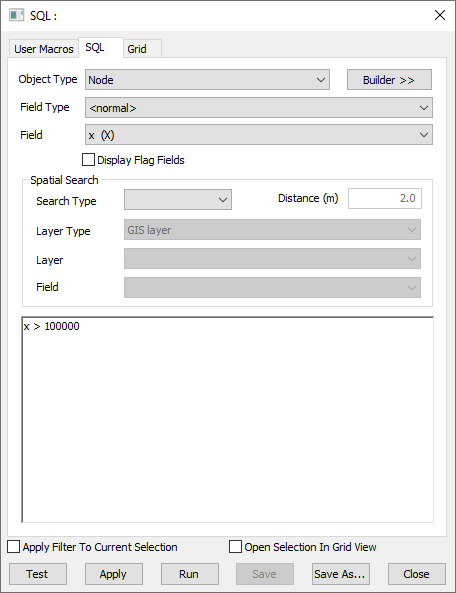

For example,
x > 100000
selects all objects of the chosen object type (selected in the Object type field of the SQL dialog) where the x coordinate is greater than 100000.
This basic selection example selects all node objects with x coordinate greater than 100000.

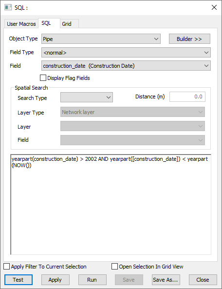

Example 1
yearpart(construction_date) > 2002 AND yearpart([construction_date]) < yearpart(NOW())
Finds all the CCTV surveys undertaken after the year 2002 and before the current year.
Object type: CCTV survey
Field: When_surveyed

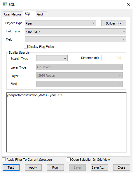

Example 2
yearpart(construction_date) - year < 2
Finds all the CCTV surveys that have been surveyed within 2 years of the pipes being laid.
