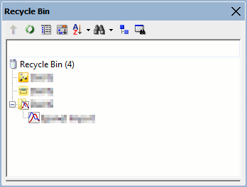

Recycle Bin window
This window shows objects that have been deleted. It can be used to restore these objects.
The window is opened by double-clicking the Recycle Bin object in the Explorer window, the Model Group window, or the General Group window.
On-premise database items are stored in the Recycle Bin until they are permanently deleted or restored to their original location.
Cloud database items are stored in the recycle bin for 30 days. After 30 days, the cloud items are automatically deleted permanently from the recycle bin. You can still restore items or permanently delete individual items or empty the bin at any time within the 30 days.
Recycle Bin window
Item Description
Toolbar This is the same as the toolbar in the Model Group window.
Tree Lists the deleted objects.
Context menu
Right-clicking Recycle Bin at the top level of the tree shows these options:
  • Restore all - Restores all objects.
  • Advanced Empty recycle bin - Empties the recycle bin of all objects.
Right-clicking an individual object in the tree shows these options:
  • Restore - Restores the individual object.
  • Other options - These are the same as for the Model Group window.
