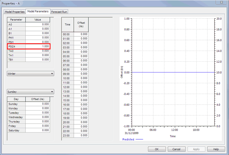

To test this, let us use InfoWorks WS Pro to build this simple prediction model by setting all the InfoWorks WS Pro parameters to zero with the exception of PSI24, which should be set to 1 in the Model Parameters page of the Properties dialog.
This way, only the measured demand from 24 hours ago will be used to predict the current demand (See Figure 1).

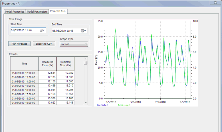

When using the simplified model, the coefficient of determination is 0.828. Figure 2 shows a graph of predicted versus measured demand for the full InfoWorks WS Pro model. This graph is visible in the Forecast Run page of the Properties dialog and the forecast may be tested for a time other than the training period (Time Range section).
Figure 2

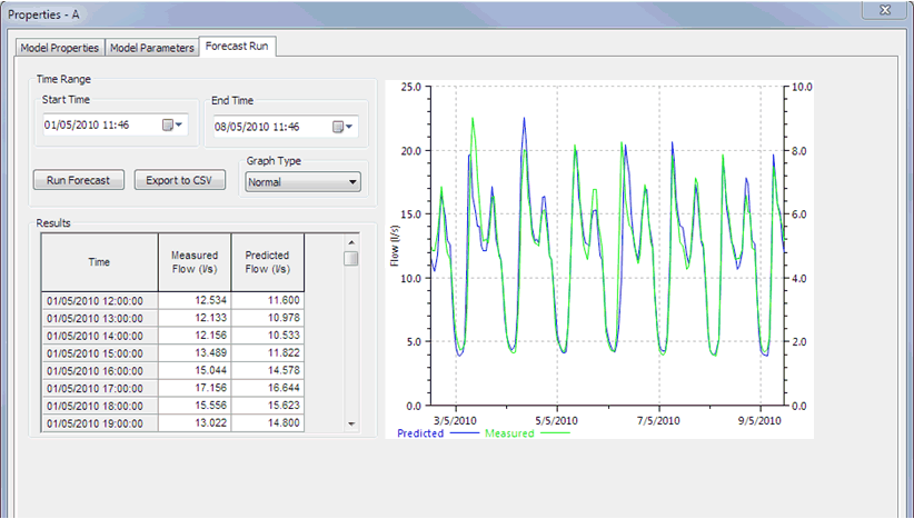

Figure 3 shows the equivalent graph for the simplified model:
Figure 3
By visually comparing both graphs it can be seen that the fit is better for the InfoWorks WS Pro model.
