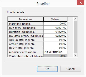

Baseline Run Schedule dialog
This dialog allows the run schedule of the currently selected baseline to be edited.
The dialog is displayed when:
  • A baseline is selected in the Model Group window or the Explorer window and the Maintenance in IWLive Pro Operator Client | Edit Schedule option is selected from the InfoWater menu.
  • The Maintenance in IWLive Pro Operator Client | Edit Schedule option is selected from the InfoWater menu and a baseline is selected in the subsequently displayed selection dialog.
Show image
Note:
The run schedule can be edited only if the baseline is checked out or checked in and not enabled.
