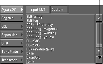

Open the Input LUT menu. See Accessing the Input LUT Menu.
In the LUT List, click the Browse button.

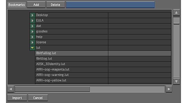

The Import file browser appears.
Navigate to the appropriate source folder and select one or more LUT files (You can also use bookmarks to retain a list of folder locations). Traditional methods of multi-selecting (Shift-click, Ctrl-click) are enabled.
Click Import.
Warning:If a LUT with the same filename is already in the LUT list, the Import button will turn red. You must click again to confirm that you want to overwrite the file.Tip:If no files are selected, you can also press Enter to cancel LUT file selection and close the Import file browser.A copy of the LUT file is imported into the lut folder, and appears in the LUT list.
