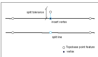

The Insert Point command calculates new point coordinates that lie exactly on the line. At the insertion point a new vertex is inserted. For further processing the vertex indicates the relation between point and line.
Optionally you can split the line at the insertion point: The existing line feature is deleted and two new line features are created instead. Whether to split a line or not can be specified in the application options.
A point is inserted into a line: Its coordinates are moved to the line.
The insertion is documented in the database: An inserted point is saved with a special reliability attribute.
If the difference between the old and new position of the point exceeds the split tolerance, the point will not be inserted and a message appears. The split tolerance can be set in the application options.
