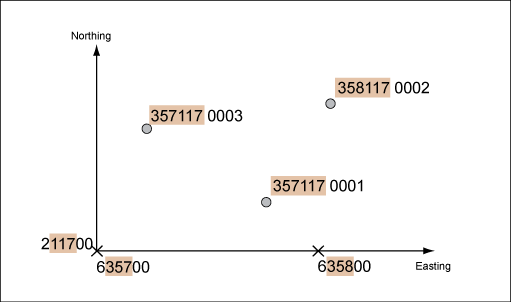

Grid 100m Point Numbering
Grid 100m point numbering generates a point number where the prefix depends on the point coordinates.
The repetitive prefix is generated from the 100 <length unit> value of the coordinates: 3 digits of the easting value + 3 digits of the northing value, so the prefix is always a 6 digit value.
The increment part can be configured for different feature class groups.

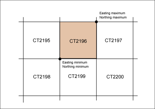

Raster Plan Point Numbering
Raster Plan point numbering generates a point number where the prefix depends on the location of the point in a specified raster.
Specify the repetitive prefix per raster. You can define your own raster.
Configure the incremental part for different feature class groups.
