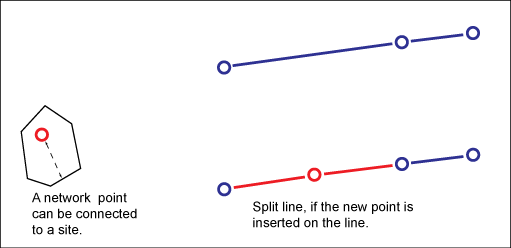

The Network Point Creation workflow splits existing lines to keep the topology correct.

  5. In the Site area, click one of the following options:
    • None – Specifies no site is associated with the point.
    • Digitize – Prompts you to create a site.
      If you create a new site, specify the geometry type for the site.
    • Connect To – Prompts you to select an existing site.

If you place the network point on a line feature such as a pipe, you are prompted to create a soft split or a hard split. For more information, see Split Lines.
