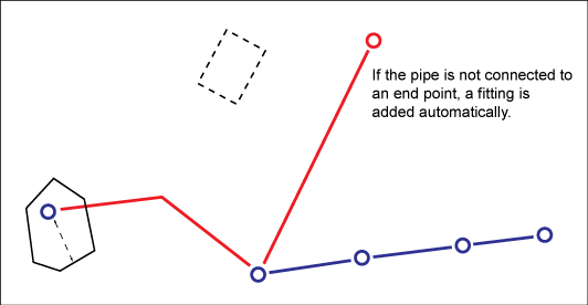

  • If a vertex of the new pipe lies exactly on an existing network point feature, the pipe is soft split, see Split Lines.
  • If you create a pipe with a start or end that is not connected to a network point, by default a fitting is created, see Feature Rule: Create Start And End Nodes.
