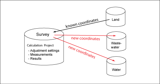

Survey Database
The Survey module stores measurements, calculation settings, and results in a separate database schema. Control points that are needed for the adjustment calculation can be stored in any industry model on the server. Also, you can distribute the new coordinates to any industry model on the server.

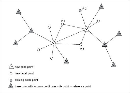

Base Points and Detail Points
In field measurements, you distinguish between two types of points, base points and detail points. In the measurement files, the points are either classified as base point or as detail point.
Base point—Geodetic point such as control station, connecting point, or geodetic network point. Base points are either points with known coordinates that are stored in the database (fix point), or they are new points, such as a free station.
Detail point—Measured point, that determines the location of a real world object, such as building corner, manhole, or border point. Other than base points they are not used as station, and they are not part of the geodetic network.
Reference Points and Existing Detail Points
Reference point—Fix point that is stored in the database. Before you start the adjustment calculation, for each base point, you search a reference point in the database. Base points that have no reference in the database are introduced as new points in the adjustment process.
Existing detail point—Detail point that is stored in the database. Before you start the adjustment calculation, you optionally search existing detail points. For example, if you have measured a detail point once again to improve or validate the coordinates, and you want to add the existing point to the adjustment process.

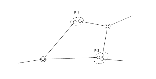

Identical Points
You normally measure detail points more than once. For example, you measure a detail point from different stations, so that the measurement is well controlled (over determination). Identical points are detail points that have been measured several times. For the adjustment process, identical points are merged, and introduced as one unknown new detail point.

After the calculation, you distribute the new points that are stored in the Survey database to their target industry models. You can distribute one point to multiple industry models, and to multiple feature classes, according to the distribution rules that are specified in the field code list.
