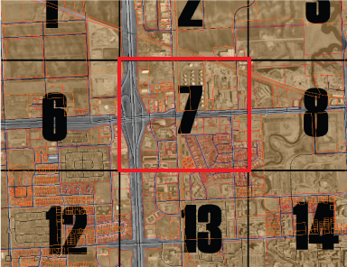

Example: You have separate drawings for each quadrant of a town. You create a main drawing and attach the other drawings, and then view all water mains in the town or all emergency routes.
Tiling is one way to manage multiple DWG files.
