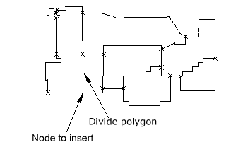

Edits to this polygon topology consist of adding a node and then dividing the polygon with a link.
