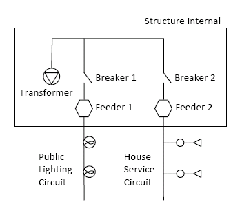

You can create a separate drawing to contain a internal view of a structure. For example, you might have a substation where a conductor in a segment is connected to an internal device (transformer/breaker/fuse). The internal devices are connected to each other with a conductor.

  9. In the structure internal .dwg, draw the internal features, for example, conductors and devices.
    Tip: Start with a conductor that has a specific length (for example, 3 meters). If you start digitizing without a value you might create a conductor with a size that is inappropriate to the device you create later.

      A logical connection is made between the external and internal features.
      The structure internal device is displayed in the Structure container in the Electric Explorer. A special icon indicates that the structure has an internal view.
