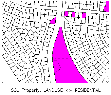

You can specify a hatch pattern to fill closed polylines and circles during the property alteration process.
Closed polylines retrieved by a query are filled with a magenta solid hatch pattern.
