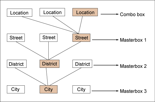

Example: Multi-relation Advanced Combobox: City ->District -> Street ->Location
Target: To assign a location (house number) to a building with the help of a combo box (BUILDING.FID_LOCATION <- LM_LOCATION.FID).
The user does not want to select the location from the table LM_LOCATION. He wants to select the city first, then the district and street, and finally the location. Each drop down list will contain only the pre-selected items.
In this example, the user can restrict the selection of the location by city, district, and street.
The following relations exist: There are several cities; every city has several districts and every district has streets and every street has locations (house numbers).
LM_LOCATION { FID, ..., Number, FID_STREET }
LM_STREET { FID, ..., Name, FID_DISTRICT }
LM_DISTRICT { FID, ..., Name, FID_CITY }
LM_CITY { FID, ..., Name }
PARENT_TABLE_NAME.PARENT_COLUMN_NAME
-> CHILD_TABLE_NAME.CHILD_COLUMN_NAME
LM_CITY.FID -> LM_DISTRICT.FID_CITY
LM_DISTRICT.FID -> LM_STREET.FID_DISTRICT
LM_STREET.FID -> LM_LOCATION.FID_STREET
LM_LOCATION.FID -> BUILDING.FID_LOCATION
The above relations must be defined in TB_RELATIONS. Now you can configure the master boxes for the feature class form Building. Master boxes are created for the FID_LOCADTION combo box.
