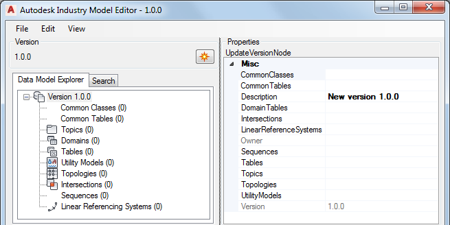

Use the Autodesk Industry Model Editor to create, update, and deploy the following:
- New data models that are based on company specific or existing industry-specific data models.
- Custom modules or extensions based on existing industry data models.
- Modifications of standard Industry data models to suit a particular country (country kit).
The Industry Model Editor creates XML files (*.genx Data Model Files) that can be shared with other companies. You apply the Data Model files in the Infrastructure Administrator to update or create data model structures.
Industry Model Editor supports schema versioning.
You can manage and edit the following data model objects:
- Topics, feature classes, label feature classes
- Label definitions
- Model feature classes, including records
- Domain tables, and domain entries
- Other tables that are not feature classes, and not domain tables
- Attributes, relations, topologies
- Utility models
- Intersections
- Indices, sequences, rows of tables
- Views
The Industry Model Editor does not support feature rules, and features (records).
Note: The Industry Model Editor supports only views that refer to feature classes in the same industry model.
