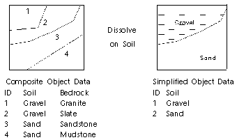

Dissolving Polygons
When you dissolve a topology, AutoCAD Map 3D toolset checks each boundary between polygons to see if the dissolve field value is the same for both. If so, the boundary and one of the centroids are removed. All object fields except for the dissolve and any new topology fields are removed.
If adjacent polygons do not contain the dissolve field, the boundary is not dissolved and the resulting polygon has a blank value for that field.
