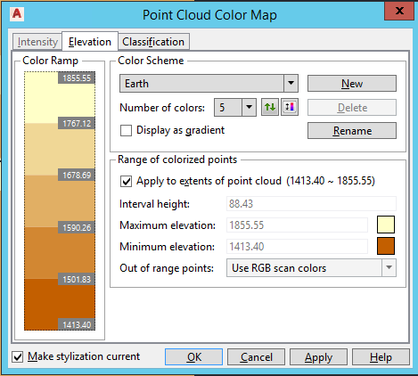

To Assign a Color Scheme
Colorization for the intensity, elevation, and classification stylizations is based upon the color scheme you assign. You can assign a different color scheme to each stylization.
  • In the Display Manager, right-click the point cloud layer you want to style, then select Set Style. In the Point Cloud Color Map dialog box, go to the intensity, elevation, or classification tab, choose a color scheme from the drop-down.
To Customize a Color Scheme
For the intensity and elevation stylizations, you can edit the color band or gradient ramp for a color scheme, and change the minimum/maximum range values to which the color ramp is applied. For the classification stylization, you can assign the color to be displayed for each classification category.
To customize the color scheme for intensity and elevation stylizations
  1. In the Display Manager, right-click the point cloud layer to style, then select Set Style .
  2. In the Point Cloud Color Map dialog box, click the Intensity or Elevation tab.
To customize the color scheme for classification stylization
  2. In the Point Cloud Color Map dialog box, click the Classification tab.
  3. To control the display of point cloud points for each classification, click the on/off icon to turn on or off the display.
  4. To change the color assigned to a classification, click the corresponding color square and select a new color.
