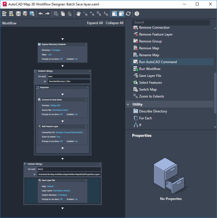

Use the Workflow Designer to edit or create workflows.
Activities in the workflow appear as a diagram in the Workflow Designer.
Utility and AutoCAD Map 3D Toolset Activities
The Activity panel on the right side of the Workflow Designer contains two categories of activities. AutoCAD Map 3D toolset activities are specific to AutoCAD Map 3D toolset (including an activity that runs AutoCAD commands).

Parallel and Sequence Activities
In a workflow, parallel activities are independent of one another. For example, when connecting to two data stores, parallel connections ensure that the second connection executes even if the first one fails.
A sequence activity depends on previous activities. For example, within the parallel activity at the top of the overlay workflow are two sets of sequence activities. Each one connects to a particular data store and then creates a layer for that data store. If the connection fails, the layer cannot be created.

Binding Parameters
Often, a sequence activity is bound to a preceding activity. When you bind an activity, you set its parameter to be the result of a previous activity. For example, you can use the output of an activity that creates a layer as the source layer for a subsequent overlay operation.
Bind the parameter for an activity to a property from a previous activity.
