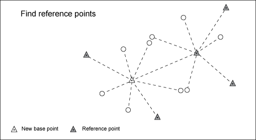

For each point that has been classified as Base Point, you search for a reference point. You use the field code list to define search rules. For example, reference points are searched by identifier, or location.
Reference points are existing base points that are stored in the database. They can be stored in any document that is part of the project . The reference points will be used for the approximate calculation, and the adjustment calculation. If a Base Point has no reference in the database, and if the required measurements are available, it can be determined in the adjustment calculation.
To reference points that are stored in documents that are not part of the workspace, see Managing additional basepoints.
For any calculation, a minimum number of reference points is required. For example, if you import coordinate files, reference points for the transformation are required. For example, if you measured free stations, reference points for the connecting points are required.
