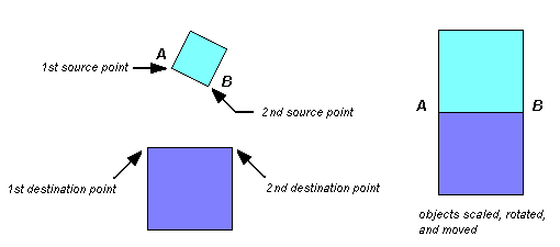

First Source Point
Select a point in your drawing or enter the coordinates of the point.
First Destination Point
Select a point in your drawing or enter the coordinates of the point. Objects are translated the relative distance between the first source point and this new point.
Second Source Point
Second Destination Point
Source and Destination Points
The difference between the first source point and the first destination point is the offset for the selected objects.
The difference in angle between the two source points and the two destination points is the rotation.
The ratio of the length between the two destination points to the length between the two source points is the change in scale.
