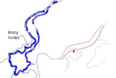

When maps are digitized, edges may be defined with more detail than necessary. Use Simplify Objects to reduce unnecessary complexity in contour lines, rivers, and coastlines. Simplifying objects, also known as generalizing or weeding, reduces the number of points on a complex line.

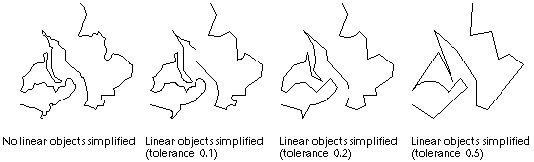

Increasing the tolerance with the Simplify Objects action removes nodes and creates a smoother profile.

Simplifying linear objects removes as many points as possible from a polyline while keeping it within the original tolerance corridor.
A coastline simplified at different tolerance settings
