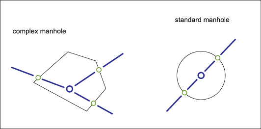

Intermediate points of a section are the points where pipes meet the structure of a manhole.

Intermediate points can be created automatically in the Section Creation workflow.
For complex manholes, the intermediate point is the intersection between the section and the polygon detail. For standard manholes the intermediate point is calculated from the diameter (stored in the WW_MANHOLE_MODEL.diameter1).
