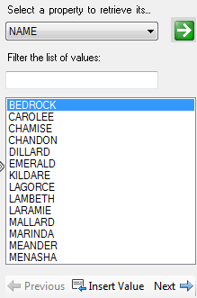

    The Properties panel is displayed on the right side of the window.
  3. In the Properties panel, click the green arrow next to the property name to see the values for this property.
    The list of values is sorted in ascending order or in the order used in the data source.
    Use the Properties panel to insert values from a list.
  4. To filter the list, under Filter The List Of Values, enter the characters to filter by. For example, enter cha to find Chamise and Chandon. Click the green arrow. The list shows all values that contain those characters.
    Note:
    Wildcards are not supported.
  5. Double-click a value to insert it in your expression, or select the value and click Insert Value.
