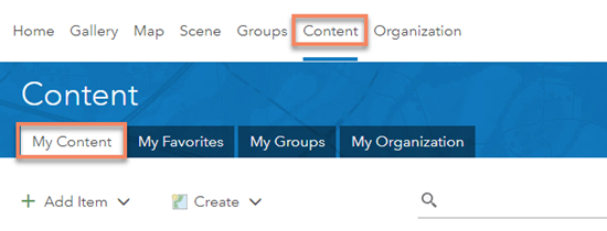

  2. On the file menu, click Content, and then click My Content tab.

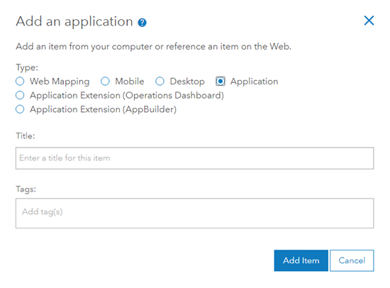

  3. Click Add Item An application.
  4. In the Add an application dialog, select Application and enter the appropriate title and tags, and then click Add Item.

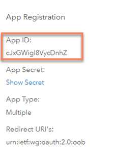

  6. Click on Registered Info (at the bottom of the page).
  7. Copy the App ID, which you will use in subsequent step to the clipboard or any text editor.
