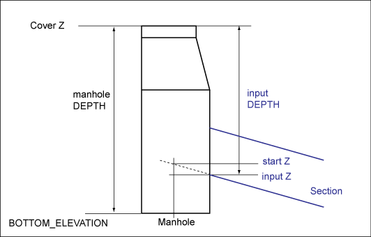

Manhole bottom elevation
Cover_Start.Z – Manhole_Start.DEPTH =Manhole_Start.BOTTOM_ELEVATION
Cover_End.Z – Manhole_End.DEPTH =Manhole_End.BOTTOM_ELEVATION
Section input and output Z
Cover_Start.Z – Section.INPUT_DEPTH = Section.INPUT_Z
Cover_End.Z – Section.OUTPUT_DEPTH = Section.OUTPUT_Z

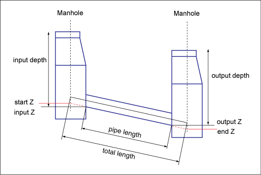

Slope (section)
TOTAL_SLOPE = (START_Z – END_Z)/TOTAL_LENGTH
PIPE_SLOPE = (INPUT_Z – OUTPUT_Z)/PIPE_LENGTH

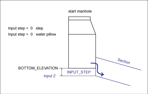

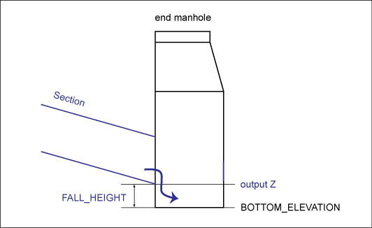

Fall height and input step
Section.FALL_HEIGHT = Section.OUTPUT_Z – Manhole_End.BOTTOM_ELEVATION
Section.INPUT_STEP = Section.INPUT_Z - Manhole_Start.BOTTOM_ELEVATION
INPUT_STEP > 0: water pillow
INPUT_STEP < 0: step.
