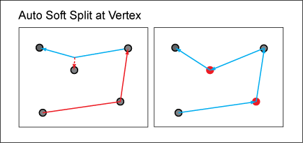

AutoSoftSplitAtVertex rule group
The AutoSoftSplitAtVertex rule group splits a line at a vertex when it is at the same location as a utility point. Depending on user data and use cases, this rule group can optionally be enabled.
  • AutoSoftSplitAtVertex_BIU
  • AutoSoftSplitAtVertex_AIU
The rule group applies to Utility line feature classes.
Name
Classification
Optional feature rule.
Location
Assembly: Autodesk.Map.IM.Utilities.dll
Classname: Autodesk.Map.IM.Utilities.FeatureRules.UtilityLineFeatureRules
Type
Client-side
Before Insert (BI); Before Update (BU).
Is System. Is Row.
Description
Looks for utility points at the vertices and soft splits the line if utility points are found.
Execute Column
GEOM
Dependency
Member of a rule group.
The rule groups only works if the AutoSoftSplitLines rule group is enabled for the corresponding utility point feature class. See also AutoSoftSplitLines rule group.
