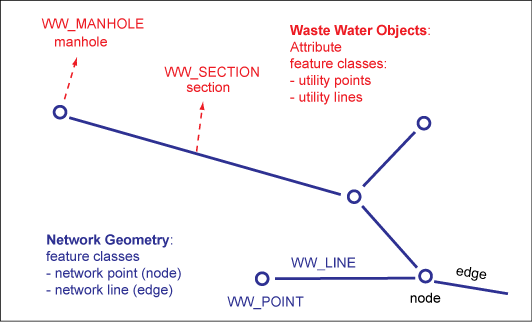

The Wastewater module is based on the Utility data model which stores geometry and attribute data separately. The data model contains topics, representations, domains, utilities, topologies, and intersections.

A representation is a template you can use to visualize a feature in different locations, and store the geometries in the database.
