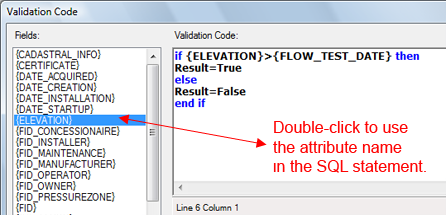

  7. In the Validation Code dialog box, enter the validation code. You can double-click the attribute names in the list to insert them into your code.

    To see the validation, open the Hydrant feature class form and enter values for ELEVATION and GROUND_ELEVATION. The error message is displayed if you enter an ELEVATION value that is higher than the GROUND_ELEVATION value.
    Control input with a validation code. If the user enters a value that does not match, the specified error message is displayed.
