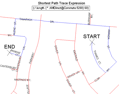

Travel Time in Network Topologies
To carry out network path trace analysis on a road network based on time rather than distance, assign a speed or speed limit to each link using an object data field or a field in a linked external database. You then set the Link Direct Resistance property to an expression that uses this speed limit data, for example:
(/ .length (* :speed@street_data 5280))
which divides the length of each link by the average speed per foot (where 5280 is the number of feet in a mile).
The resulting analysis shows the shortest route, in terms of time, not distance, to get from the first point to the second.
