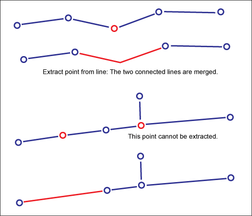

If you delete a point, you must update the network topology to keep the network consistent. For example, if you delete a network point, you must merge the two connected lines. If more than two lines are connected at the point, you are not allowed to delete the point.
  1. Click the Industry Model explorer icon.
  2. Right-click the point feature class and click Extract From Line.
  3. When prompted, click the point you want to delete.
    The point is deleted from the database and the connected lines are merged.
Network topology: Extracting points from a network line
