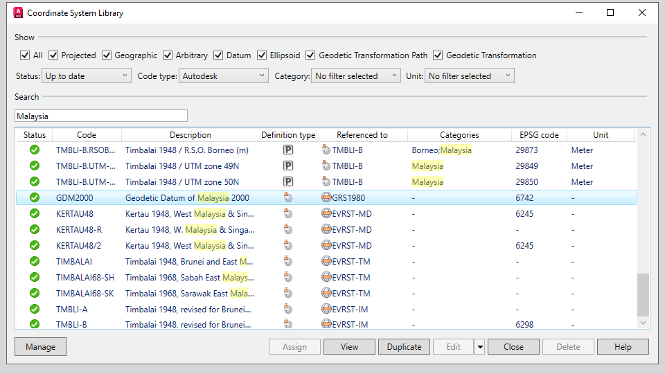

AutoCAD Map 3D 2026 includes the following updates related to the coordinate system:
  • New horizontal coordinate systems
    • UK Rail Coordinate Systems
    • Malaysia 2000 Coordinate Systems
    • Saudi Arabia EPSG 20439
  • New first-class vertical coordinate systems
    • Vertical transformation between ETRS89 and ODN
    • Coordinate Systems ETRF89.OSTN15_height
    • Switzerland Vertical Coordinate Systems
      • EPSG code: 5728, 5729
  • Updates to coordinate system definitions
    • Correction of the EPSG code for the CzechJTSK/5b.Krovak Coordinate System
    • Fixes for name mapping issues with datum MGI-1901/Kos
    • Updates to Serbia Coordinate Systems
    • Correction of the EPSG code for Autodesk AinElAbd.UTM-39N
    • Addition of the ESRI WKT string for EPSG 6751 Coordinate System
    • Correction of coordinate system information for AinElAbd.UTM-39N
    • Correction of the coordinate system boundary for Jackson County, MN
