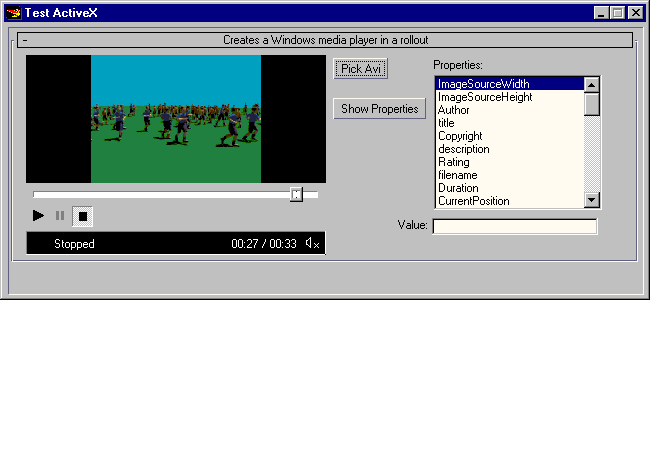

The following example creates a Windows Media Player in a rollout.
  • You can load an avi file by clicking the "Pick Avi" button and choosing an Avi file from disk.
  • When the play button is hit the "on timer..." event is called. This synchronizes the time slider with the active frame in the media player!
  • Click "Show properties" to get all the properties listed in the listbox.
  • You can get a property's value by selecting the property name from the listbox.
  • You can also set a property by picking a property from the listbox and entering the new value in the text field below.
