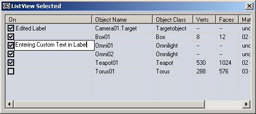

.LabelEdit: ListLabelEditConstants( #lvwAutomatic | #lvwManual )
Controls the editing of the label (this is the text in the first column of a ListItem). Default is #lvwAutomatic .
When set to #lvwAutomatic , the user can click to select the item, then click again at the label location to open the text field to type in custom text.
When set to #lvwManual , the label editing can only be initiated by the developer by using the .StartLabelEdit() method.
The 3ds Max keyboard shortcuts (accelerators) have to be disabled to be able to type in the label text field! See ActiveX - Disable3ds Max keyboard accelerators for details!

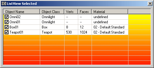

The following screenshots show the default white background (.BackColor property not set), .BackColor = color 225 215 210, .BackColor = color 215 225 210 and .BackColor = color 210 215 225

In the example below, a yellow-red gradient with the size 500x200 pixels was created in Photoshop, saved as 24 bit BMP to disk and passed to the .Picture property using the line
lv.picture = loadPicture "c:/3dsmax6/images/activex_gradient.bmp"

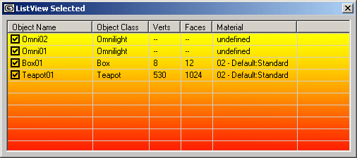

.TextBackground : ListTextBackgroundConstants( #lvwTransparent | #lvwOpaque )
Controls the appearance of the text background. When set to #lvwOpaque, the above example will appear as
