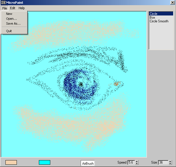

In this step of the Bitmap Painting tool development, we will add a main menu bar with New, Open, and Save options.
NATURAL LANGUAGE
We will define a new right-click menu with some menu items and corresponding event handlers.
We will assign the right-click menu as menu bar to the dialog.

Step-By-Step

We will define a second bitmap called background. It will not be used now, but will be needed in the next tutorial to allow for an eraser function.
local currentPos = lastPos = [0,0]
rcMenu CanvasMenu (
This is a right-click menu definition.
subMenu "File" (
The first item in the menu will be called File. A typical program implements File, Edit, and Help items in its main menu, so we will define these too.
menuItem new_menu "New"
menuItem open_menu "Open..."
menuItem save_as "Save As..."
Inside the File menu, we will add some menu items to start a new drawing, open an existing one, and save the results to a file on disk.
separator file_menu_1
This is a separator that draws a horizontal line between the menu items.
menuItem quit_tool "Quit"
This menu item will be used to quit the tool.
subMenu "Edit" ( )
We will leave the Edit menu empty for now.
subMenu "Help"
menuItem about_tool "About MicroPaint..."
The Help menu will contain only the about item.
on new_menu picked do
This is the event handler of the File > New menu item. If the user selected it from the menu,
theBackgroundBitmap = theCanvasBitmap = bitmap bitmapX bitmapY color:MicroPaint_CanvasRollout.paperColor.color
we will define a new bitmap using the new paper color (background color) added to the User Interface, and will assign to the painting canvas and the new background bitmap.
MicroPaint_CanvasRollout.theCanvas.bitmap = theCanvasBitmap
Then, we assign the result to the User Interface bitmap.
on open_menu picked do
This is the event handler of the File > Open menu item. If the user selected it from the menu,
theOpenBitmap= selectBitmap()
we open the standard Bitmap picker dialog of 3dsmax. It provides options to preview all supported file formats.
if theOpenBitmap != undefined do
If the user picked a valid bitmap and did not cancel out,
copy theOpenBitmap theCanvasBitmap
we copy the bitmap that was opened into the painting canvas,
copy theOpenBitmap theBackgroundBitmap
and into the background bitmap. The copy method resizes the original to fit the size of the canvas.
close theOpenBitmap
Finally, we close the opened bitmap,
and assign the painting canvas to the User Interface bitmap.
on save_as picked do
This is the event handler of the File > Save As menu item. If the user selected it from the menu,
theSaveName = getSaveFileName types:"BMP (*.bmp)|*.bmp|Targa (*.tga)|*.tga|JPEG (*.jpg)|*.jpg"
we open the standard file saving dialog of 3ds Max and provide a list of some file extensions. You can add any supported file formats such as, RLA, RPF, and so on to this list.
if theSaveName != undefined do
If the user specified a valid name and did not cancel out,
theCanvasBitmap.filename = theSaveName
we set the file name of the painting canvas to the selected name,
save theCanvasBitmap
and save the bitmap to disk.
on about_tool picked do messagebox "MicroPaint\nMAXScript Tutorial" title:"About..."
If the user picked the Help > About menu item, we open a message box with some text. You can add your own text to this dialog with version number and others.
on quit_tool picked do destroyDialog MicroPaint_CanvasRollout
If the user picked the File > Quit menu item, we destroy the dialog. Later, we can add a prompt whether the current painting can be saved to disk.
rollout MicroPaint_CanvasRollout "MicroPaint"
bitmap theCanvas pos:[0,0] width:bitmapX height:bitmapY bitmap:theCanvasBitmap
colorpicker inkColor height:16modal:false color:black across:5
To add the paper color (background color of new images), we have to increase the across: parameter to 5.
colorpicker paperColor height:16 modal:false color:white
This colorpicker adds the paper color (background color of new images). Note that the color pickers are modeless and can be kept open all the time. You can also drag and drop colors to copy colors between the Ink and Paper color pickers, or drag and drop from other areas of 3ds Max.
checkbutton airBrush "AirBrush" width:50
spinner AirBrushSpeed "Speed" range:[0.1,50,10] fieldwidth:30
spinner BrushSize "Size" range:[1,50,10] type:#integer fieldwidth:40
listbox BrushShape items:#("Circle", "Box", "Circle Smooth") pos:[bitmapX+5,0] width:90
fn paintBrush pos =
case BrushShape.selection of
1: (
if distance pos currentPos <= BrushSize.value/2 do
setPixels theCanvasBitmap pos #(inkColor.color)
2: setPixels theCanvasBitmap pos #(inkColor.color)
3: (
theFactor = (distance pos currentPos) / (BrushSize.value/2.0)
if theFactor <= 1.0 do
theFactor = sin ( 90.0 * theFactor)
thePixels = getPixels theCanvasBitmap pos 1
if thePixels[1] != undefined do
thePixels[1] = (thePixels[1] * theFactor) + (inkColor.color * (1.0 - theFactor))
setPixels theCanvasBitmap pos thePixels
)--end case 3
)--end case
)--end fn
fn drawStroke lastPos pos =
deltaX = pos.x - lastPos.x
deltaY = pos.y - lastPos.y
maxSteps = amax #(abs(deltaX),abs(deltaY))
deltaStepX = deltaX / maxSteps
deltaStepY = deltaY / maxSteps
for i = 0 to maxSteps do
if airBrush.checked then
for b = 1 to (BrushSize.value / AirBrushSpeed.value) do
paintBrush (currentPos + (random [-BrushSize.value/2,-BrushSize.value/2] [BrushSize.value/2,BrushSize.value/2] ))
else
for b = -BrushSize.value/2 to BrushSize.value/2 do
for c = -BrushSize.value/2 to BrushSize.value/2 do
paintBrush (currentPos + [c,b])
currentPos += [deltaStepX, deltaStepY]
on MicroPaint_CanvasRollout lbuttondown pos do
lastPos = pos
isDrawing = true
on MicroPaint_CanvasRollout lbuttonup pos do isDrawing = false
on MicroPaint_CanvasRollout mousemove pos do
if isDrawing do drawStroke lastPos pos
lastPos = pos
) createDialog MicroPaint_CanvasRollout (bitmapx+100) (bitmapy+30) menu:CanvasMenu
We add the RightClick menu defined in the beginning of the script to the dialog.
MicroPaint_CanvasRollout.theCanvas.bitmap = theBackgroundBitmap
After starting the tool, it is a good idea to clear the display, as the bitmap might be still displaying an older version from a previous painting session.
